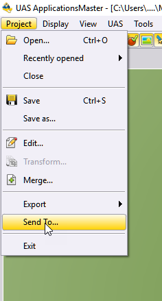

    Project > Send to..

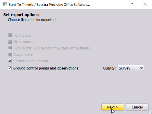

    Select "Cameras and photos", and Ground control points. Hit Next >
    Don't click Send on the last window, instead navigate to the project directory, in the BC_DATA folder. There is a *.XML file containing the camera and exterior orientation data.
