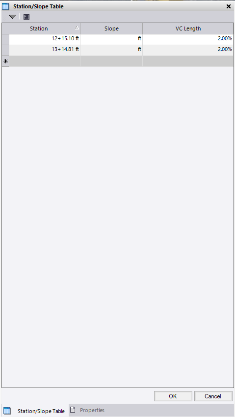

    I have attached a image of how my copied row look when pasted in a new table. The slope is copied into the VC Length column insteaad of the Slope column.

    They say a picture is worth a thousand words. Very true in this case.
    If you have display suffix turned on in project settings, the station is formatted as "12+15 ft" instead of "12+15". The problem is when we paste the info back into TBC, we break the string up at every TAB, "list separator (usually comma)" and SPACE character. That's why the "ft" goes in the second column.
    I will remove the SPACE character from the list of separators.

    The way to fix your issue is to do the following
    1) Go To Project Settings, Select Units, Select Station and open the Suffix setting and change it to NO - that will remove the suffix value in that field which is currently causing your issue.DO the same for the Distance Units and set that to No also.
    We will fix this today now that we have tracked it down. Thanks for raising the problem and making TBC better!

    Did and Done.  This worked and will use this until the next version is released.
