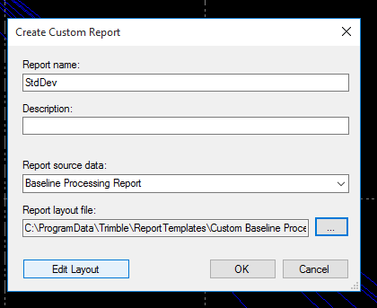

    Does anyone know how to export vectors with their standard deviations sx, sy, sz?
    For example:
    From To dx dy dz sx sy sz
    T1 T2 250,222 365,235 152,222 0,0023 0,0042 0,0058

    This information is available in the Baseline Processing Report:
    To get it in the the specified format your best bet would probably be to create a custom report based off the Baseline Processing one.
    You could then create your own or modify an existing table with the required information and delete extraneous information from the report.

    Thank you so much
    It works
