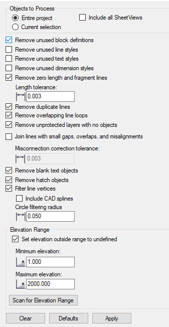

    I ended up running project clean up with the following and turning off do not track breaklines
    and it shrunk it down to 77 megs.

    Thanks, The VCE file that I sent was actually one that I just made quick because the same issue was happening in the main file that I'm using which is actually a little smaller. I exported the surfaces out of the main file, and imported my boundaries just to see if the same issue occurred. It did, so then I imported the design linework and made some new quick and dirty surfaces (hence the multiple same surfaces with different names) to try that, and had the same problem. These files have been somewhat of a pain to work with, every cad arc, and several lines were set to a different UCS, so I've had to do a lot of manual cleanup that the project cleanup wouldn't fix on it's own.
          I did just run the project cleanup on my main file, and re ran the EW report with success, thank you for the help. I wonder what it is in the imported files that causes this? Must be those UCS arcs that come in way off in elevation but tie into the surface fine.
