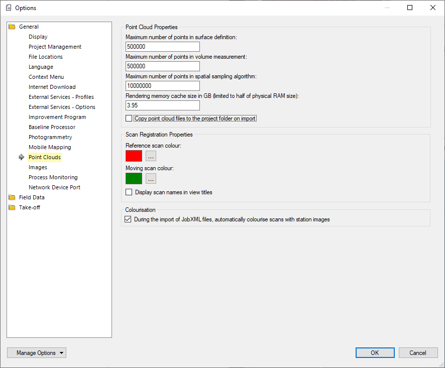

    Just to add my 2c worth in to this because ive been looking at this as well. I use point cloud data a fair bit for earthworks with some LAS files around the 1Gb size and TBC has a built in limit to use half the ram the computer has availiable, now i dont know if this limit is applied to other aspects of the program.
    Another factor to consider is generally when i work i have Chrome open for earthworks reports, online doc control for the project etc and pdf software as well which are both ram hungry programs so they are all competing for the their slice of availiable ram.
    I read somewhere as well that once memory devices get to 80% utilisation that they start to slow down after that because they have to handle large volume of data (coupled with windows 10 issues with standby memory it wont release) lower ram computers can start to bog down pretty quickly from my experience.
