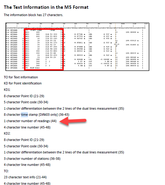

    From the DiNi Manual Below.  The number after the 2 digit seconds is actually the number of readings taken and not a partial second.  By definition the time only has 8 characters and there is no space between time and the number of readings.

    Thanks Neil.  That explains it.
    I would still like to see a space between the time and number of readings though!  (Although I can split it in MSExcel by using the 'fixed width' limiter...)
