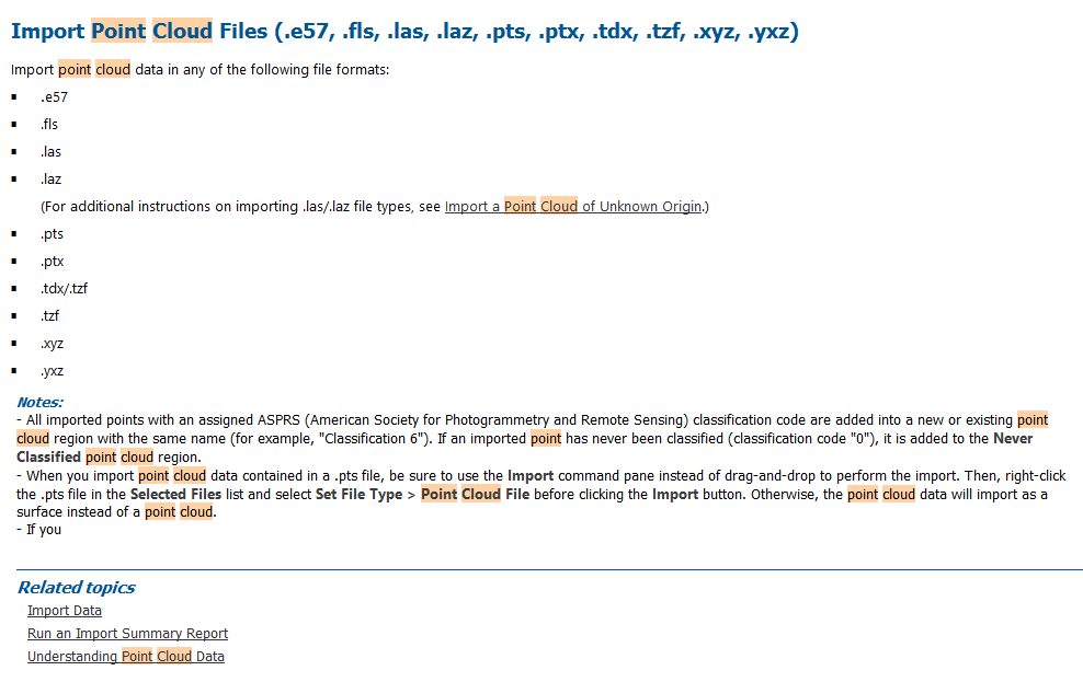

    It is an ESRI .arc point cloud file.  It has an origin grid spacing and a series of elevations.  We don't currently read this format.  I looked a bit and could not find a converter on the web.  For point clouds we can read the following.  Some of these formats contain the coloration others are just ascii points files.  See if you can get one of these formats.

    Thank you Tim! I figured it probably wasn't compatible. I will request a file extension matching one of the above formats.
