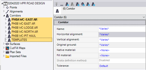

    I have a project with some 300 Alignments. This is an Urban Infrastructure development. I have to create 300 Corridors, one for each alignment. Then there will be Junctions and Round Abouts. Original Ground may get revised over time while I re-engineer the corridors. Is there a way to change the "Original Ground" for all 300 or a selected number of corridors all in one go?
    Thanks.
  • 2.  Re: Original Ground in Corridor
    Posted 03-12-2020 08:23
    Yes, Shift click the corridors in Project Explorer and look at them under properties

    Perfect. Thanks.
