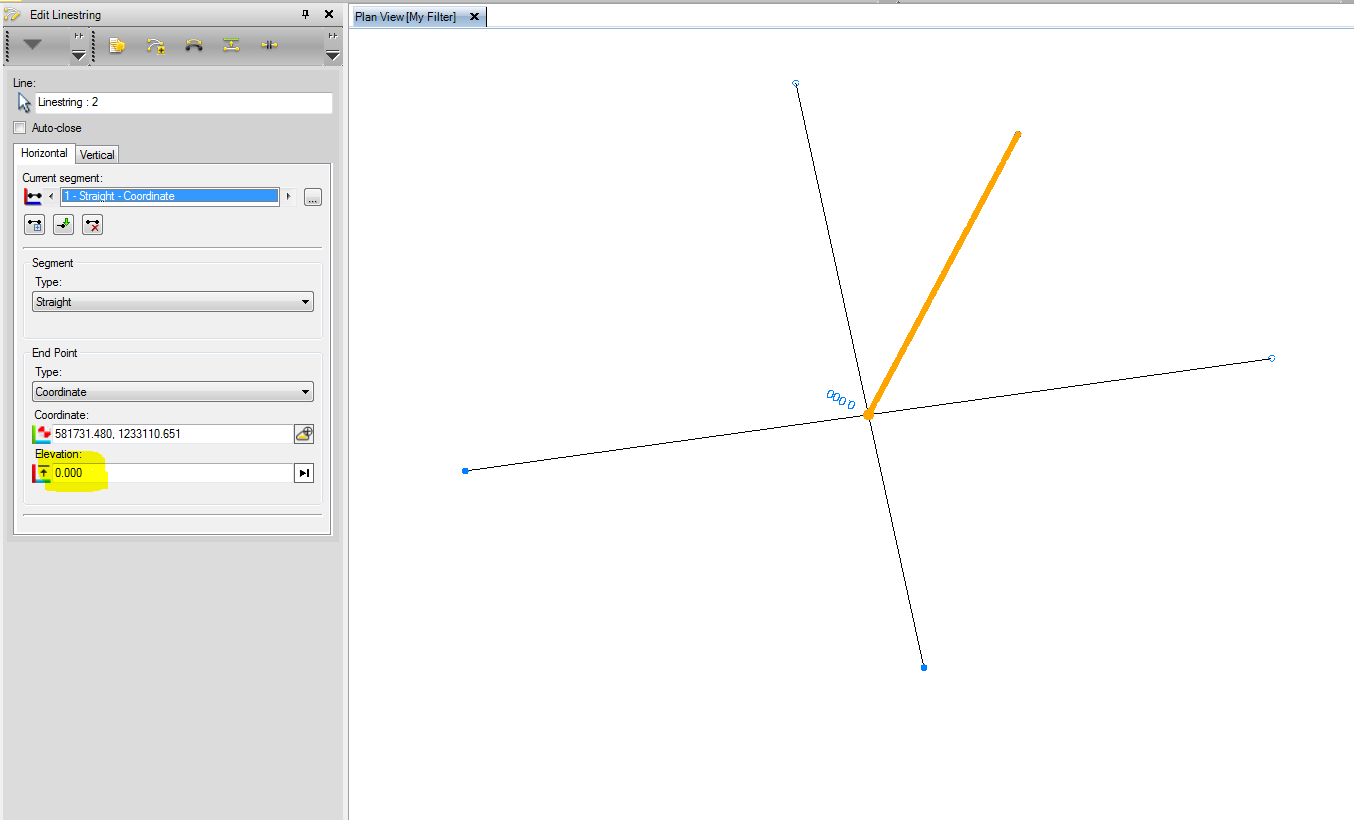

    Opened a new blank project, draw two intersecting linestrings with both with undefined elevations. Draw a third linestring into the Intersection of the two undefined linestrings and the elevation field default populates 0.00...... I don't remember the elevation field populating to 0.00 by default ever unless the line was at the actual o.oo elevation.

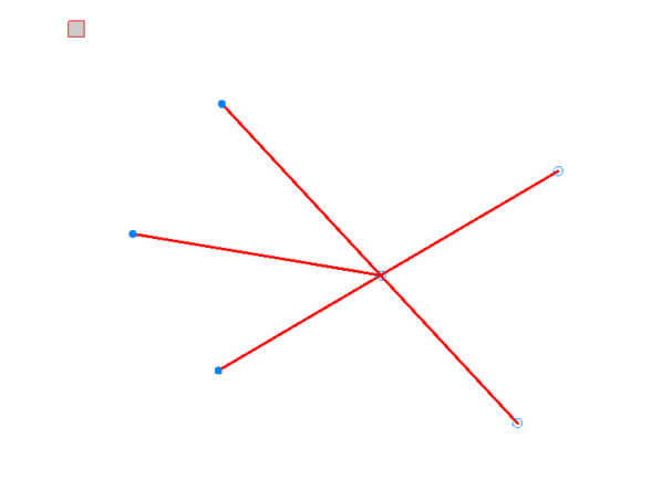

    I just tried this in the 4.12 Patch that is being prepared for release.

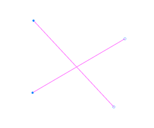

    If I create 2 Linestrings with undefined elevation as shown below
    and then turn on Intersection snap and draw from a location with undefined elevation to the intersection of the two lines (which has no elevation) I get the coordinate and the Elevation field is left blank and it is created as Undefined when I click OK to Accept that location.

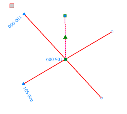

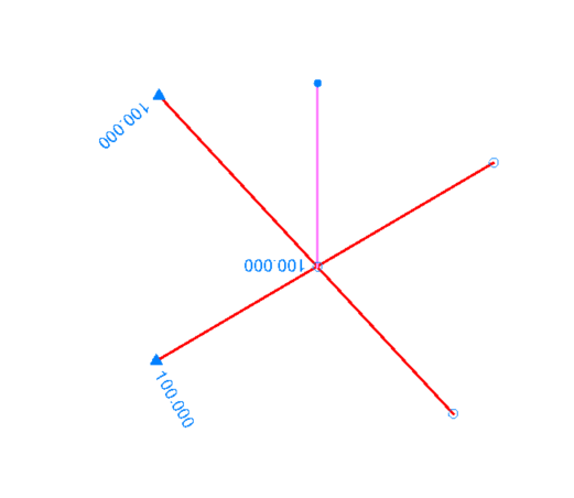

    If I use the same two linestrings and elevate them both to an elevation of 100' and then draw a new linestring from a location with undefined elevation to the intersection of the two lines (which would now be at 100') then the second node created has an elevation of 100'
    If I use the same two linestrings and change one of the elevations to 105' so that at the interersection the elevation could be 100, 105 or the mid point of 102.5 the software takes 105 as the elevation
    It always seems to take the Highest Value of the Intersection - I tried changing each line in turn and it always picked the highest elevation at the crossing location.

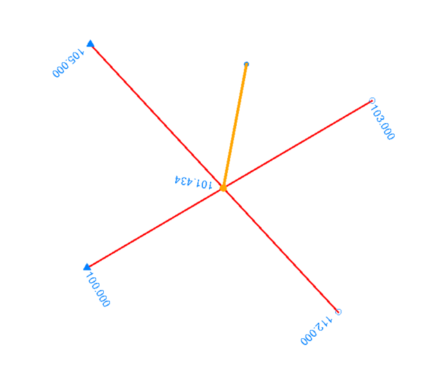

    I also tested with the following condition
    In this case I would say that we are inconsistent with the earlier adopted practice and that we did not take the higher location in this case but the lower condition (this to me is inconsistent behavior - I would agree)

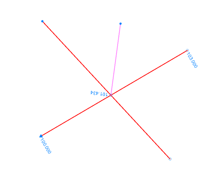

    In this case it has extracted an elevation from the elevated line (which is the best it can do and I think is correct behavior)
    In this example I turned off the Extend Vertical Property of the linestring so it has no elevation at the Intersection point  so again the intersection elevation is computed from the lower string. When there is only one VPI of 105 elevation, it auto applies 105 to the whole line until you add a 2nd VPI (again I would say this is the correct behavior).
