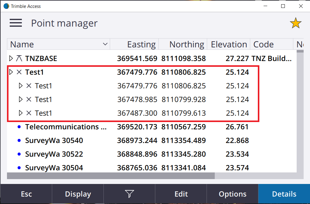

      |   view attached
    If you use "store another" it will always store a separate observation.
    Just did a quick test in the simulator.
    In the CSV file though it only exports the first one.
    Test1,367479.776,8110806.825,25.124,
    If you import the job into TBC you'll see all of them again.
    On the map in Access it'll also just show the first one, but you can review the others and they'll be highlighted as yellow dots.

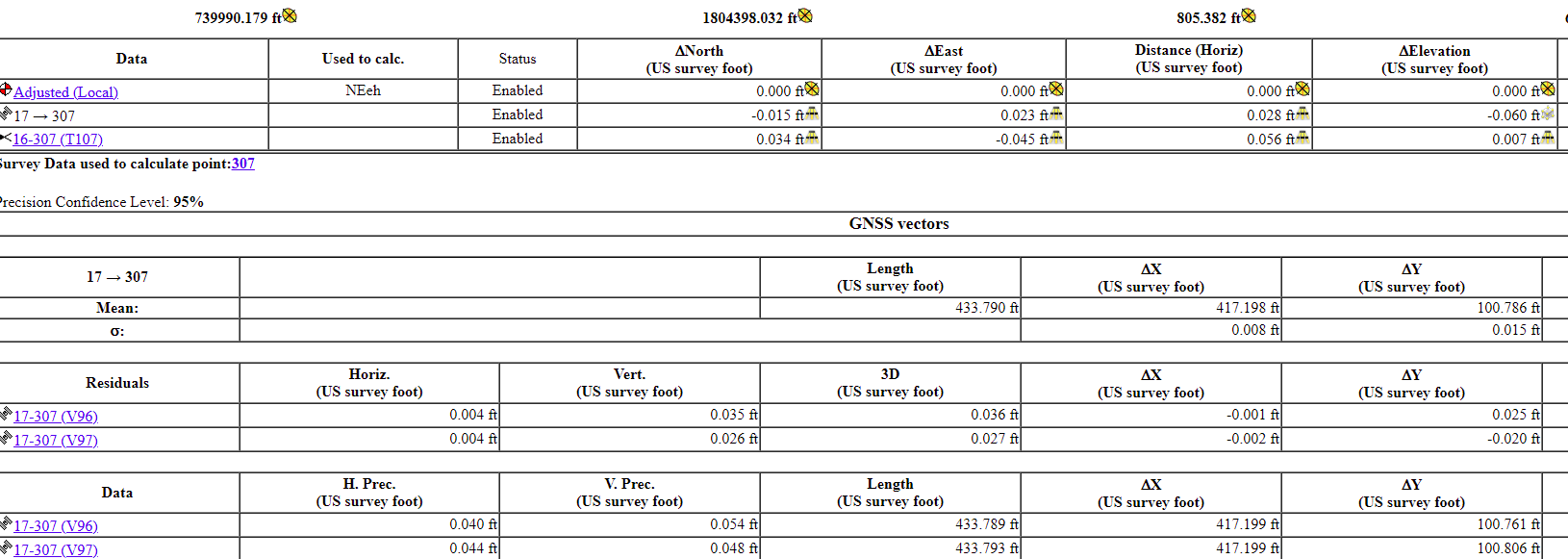

    TBC has a computation setting for single observation or weighted mean.  Choosing single observation will have TBC compute the position using all your observations in a weighted manner, not just using the first observation.  If you choose weighted mean setting in TBC, it will only show a weighted mean value in a point derivation report with longer observations and/or a RTK observation from more than 1 base point.
    I'm not sure if TBC does a "simple" average of GNSS observations as TA can do.   A great way to illustrate how TBC handles multiple GNSS observations to a single point name is to do a point derivation report when selecting a point. It will show the observations relative to the value it calculated.  Here's an example, though with a network adjustment, of RTK and total station observation.

    A handy way of finding out how a point's coordinate was computed in TBC is to run a Point Derivation Report.  If you select any point and right click you will see an option for this report.  Its a great way to see what observations TBC is using to compute the point and how far off other observations are to the computed point.
    Hope this helps!
