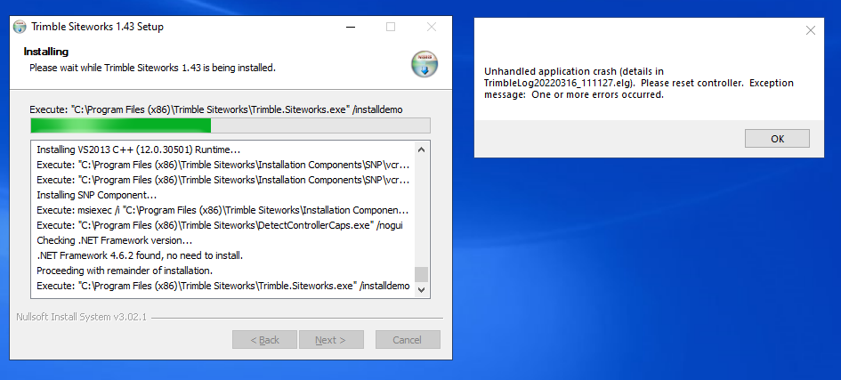

    I'm installing Trimble Siteworks 1.43 (As an emulator), and haven't been able to get it working.
    Since then, I've run the clean up utility and now reinstalled Siteworks 1.43.
    Now, on the installation of Siteworks, I get the following, "Unhandled application crash (details in TrimbleLog20220316_111127.elg). Please reset controller. Exception message: One or more errors occurred.
    Does anyone know where I can find this log (as it's not int he program files directory). and what a solution might be?
    Cheers,
    Julius
    Julius Newman
  • 6.  RE: TBC - Works Manager - Field Type Simulator
    Posted 03-16-2022 08:19
    Update here.
    Have run this on a separate computer and it all worked fine. Will get IT onto it, as it's possibly a hardware issue.
