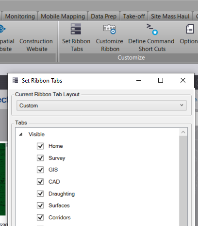

      |   view attached
    Hi Ron.
    Yes, I installed 5.4, but it was in december 2020..... so the change wasnt caused by the installation and I am not stupid to make this alert right after new fresh installation. Simply I closed TBC on friday afternoon and monday morning it looked diffrent = new tabs, no my settings and wrong and lost buttons.
    I understand that there are new tabs that I have no licence for, I am not suprised.
    But as you can see I cant hide them. And you can see some of the broken buttons (elearning, 3d view and so on)
    There was may be a windows update, it is the only one thing that comes to my mind that can did something deeper. But it shouldnt cause that, should it?

  • 6.  RE: Whats up with TBC from last friday?
    Posted 01-14-2021 02:55
    I have to correct previous post....
    I overlooked the check box "Show only licenced tabs"....... my mystake........ now I can hide the tabs
    Luboš Bejček
