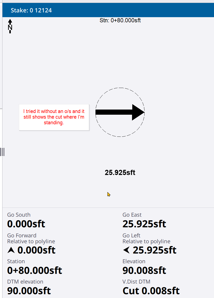

    Posted 01-31-2022 15:20
    I would like to give my field hands line work and a DTM then they can give a station offset horizontally to the line work with a cut/fill to the DTM where the line work is not to where they place the stake. Has anyone found a way to do this?

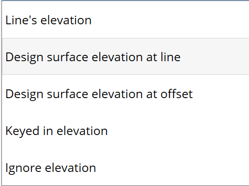

    Yes this is possible. It needs to be set up in Options prior to staking the line. See the following section of the help for more details:
    https://help.trimblegeospatial.com/TrimbleAccess/latest/en/Stake-show-cut-fill-to-DTM.htm

  • 3.  RE: Staking line work using a DTM elevation in ACCESS
    Posted 01-31-2022 17:01
    I guess I don't understand the instructions, because I do not get the DTM elevation at the line. I get it where my GPS position is.

  • 4.  RE: Staking line work using a DTM elevation in ACCESS
    Posted 01-31-2022 19:33
    I assume you have bottom of trench/conduit design as linework and a FSL, and you want to set out offset pegs but write down the depth at the conduits location?
    Access can't do that. You'd need linework that is draped onto the surface and then stake out to that line work.
    Access also can't setout to two lines at the same time. You'd have to setout one of them as Alignment/Road and one as Polyline, and switch forth and back between both programs.
    It is a huge drawback in comparison to Siteworks/SCS900 "Reference Line".
