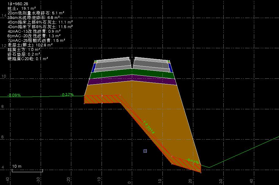

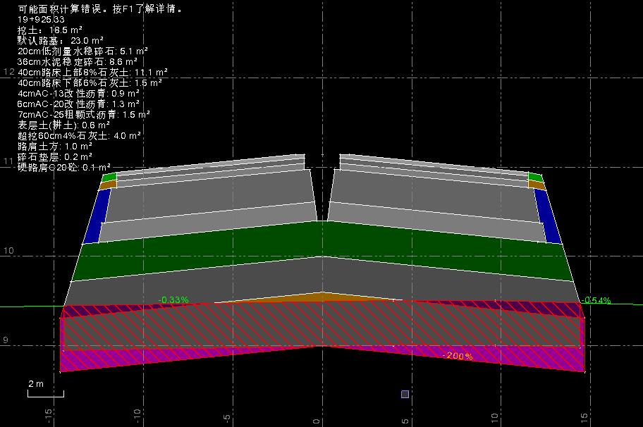

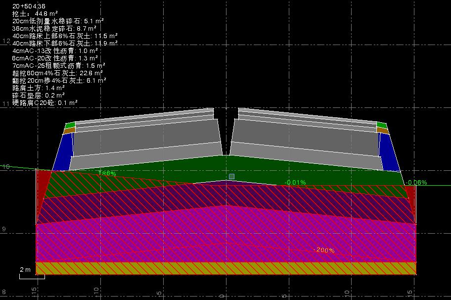

    Hello everyone, I'm from China. I'm using TBC 5.40 to calculate the highway project. When I encounter the corridor template setting to calculate the amount of material layer, I hope to get everyone's help. Mayb
    e because the construction technology of each country is different, I can calculate this project: Accurate quantities of all road structure layer materials in the original ground to the finished face. thank you all!

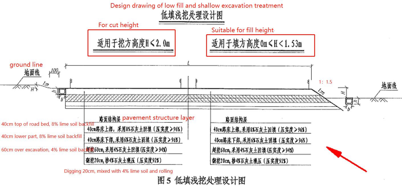

    我需要计算道路完成面以下的材料层工程量,图纸中说明,1、填土高度H<1.53M,清除表土开挖至路床底面标高后,向下反挖三层共计60cm,采用4%石灰改善土换填,再向下翻挖一层20cm,原地掺4%石灰改善。2、H>1.53M,清表50cm,挖至路床底层。路床80cm分别为40cm下部6%灰土层,40cm上部8%灰土层,路面结构层。I need to calculate the engineering quantity of the material layer below the road completion surface. It is stated in the drawings that 1. The filling height H<1.53M. After removing the topsoil and excavating to the bottom elevation of the roadbed, dig down three layers for a total of 60cm, using 4% Lime is used to improve soil replacement, and then a layer of 20cm is dug down, and 4% lime is added in situ for improvement. 2. H>1.53M, clear the surface by 50cm, and dig to the bottom of the roadbed. The 80cm roadbed is respectively 6% lime soil layer in the lower part of 40cm, 8% lime soil layer in the upper part of 40cm, and pavement structure layer.

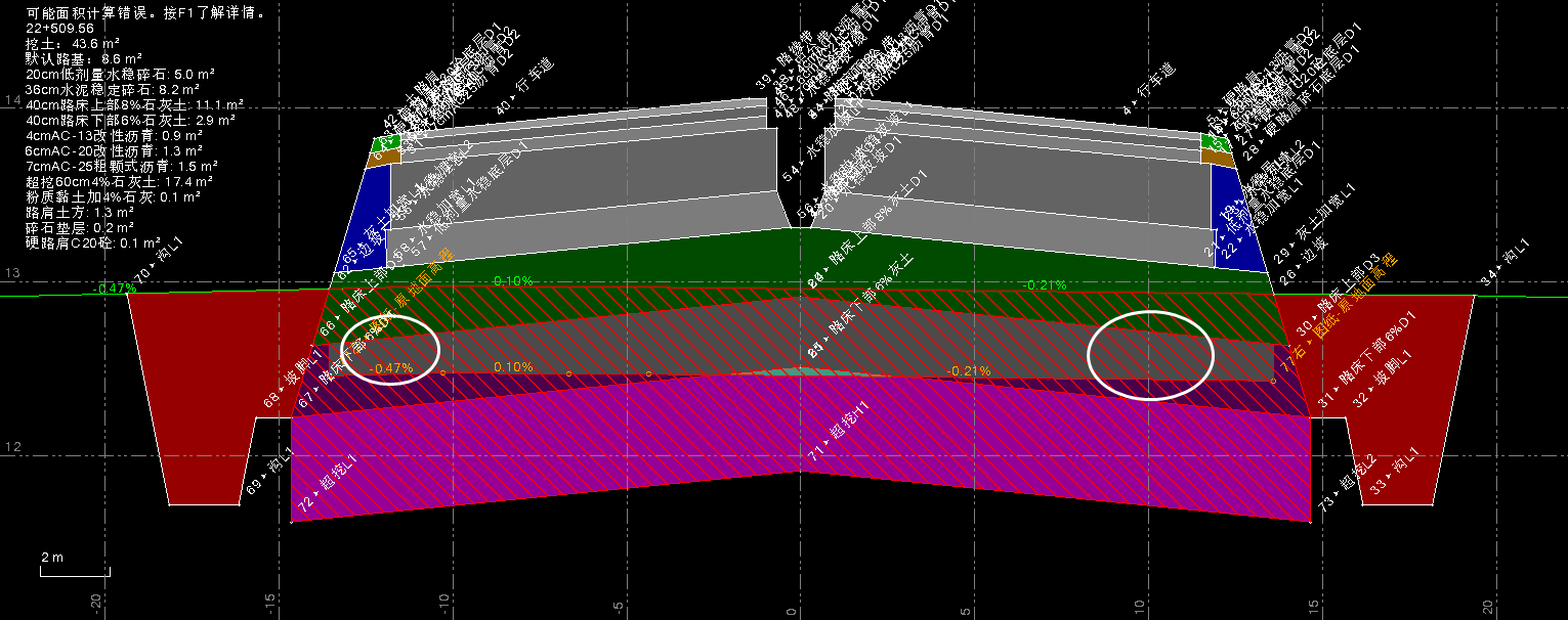

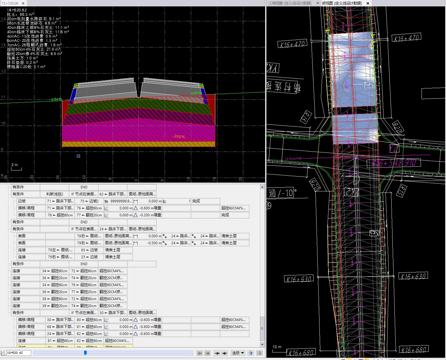

    Digging to No. 71, the material of the structural layer in the middle of the backfill is reducedDigging to No. 71, the material of the structural layer in the middle of the backfill is reduced
