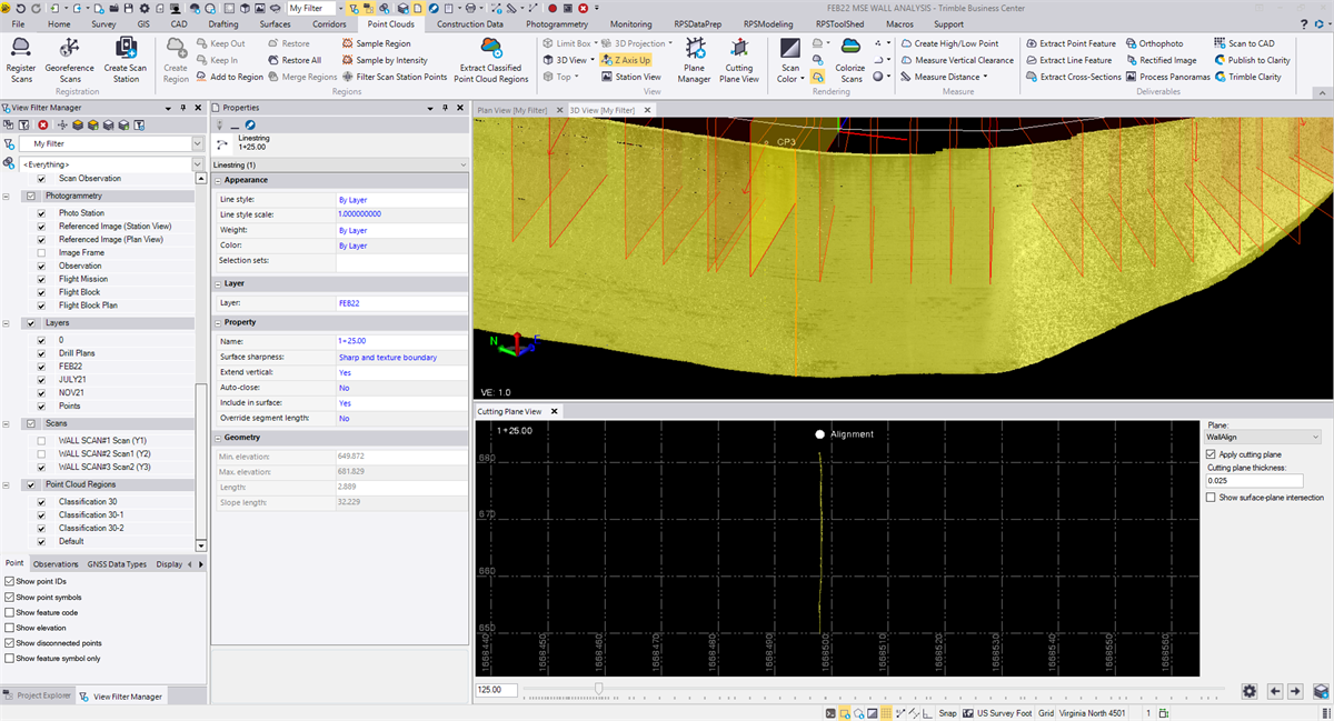

    I have a scan of wall where I leveraged TBC's Point Cloud Tool: Extract Cross Sections.  I was successful creating line strings along the wall face at 25ft station increments, and can see the generated lines in Plan View and 3D View.  However, I can not visualize the new line strings in the Cutting Plane View to QC vs. point cloud now despite the fact the extracted line strings were all created/correlated to the wall alignment station increments correctly.
    Is there a TBC setting that controls whether these "extracted" cross section line strings are viewable in the Cutting Plane?  I even tried to export these to .dxf, and turned option on to convert to 2D CAD polyline and reimported and they still don't show in Cutting Plane. I am on TBC v5.6.2
    Shows selected
