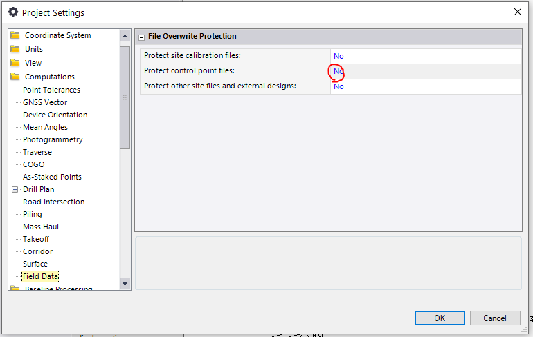

    I have been trying to find ways to update field control points onto Trimble business center upon synchronizing with office synchronizer.
    So that I can update some of the control points made on site to other controllers as well.
    It seems that flicking on/off of below doesn't do much? or I am not doing it properly?
    Has any of you had similar issue?

    As far as I know TBC doesn't know how to handle the field control points files from multiple controls due in part to having points with the same point number.  That's why you will not see them in your TBC file when you sync or update your Trimble sync data folder.  What I have done is bring in the project control via csv file as grid only points.  That way you can add them to your site and it creates the . office control file which can not be edited in the field.  I then just create a  running csv file of field control points that I keep up to date and copy and paste it back to all the controllers so everyone has the data.  It is not ideal but its what works for me.  However, you could import the new control points into TBC like you did the original project control (grid only) and keep adding those points to your site and it will update the .office control file to every controller.

    Try this setting.
