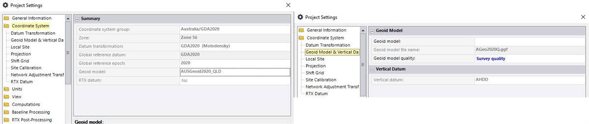

    I've been trying to set up TBC 5.4 with our custom geoid files and have been having issues making them selectable.

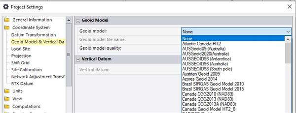

    As soon as I update the vanilla 5.4 install with GPS Config 20.12.31 my geoid files are not selectable in one of the drop downs.
    Are we supposed to be adding them to CoordSystemDatabase.xml now to make them visible? It did fix the issue but not something required in previous versions.
    Not visible here
    But I can see my QLD Geoid Models in this area.

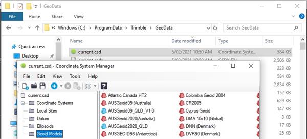

    I was able to get the geoid models to show in the geoid list inside TBC by doing the following:
    I pasted the geoid models you provided in C:\ProgramData\Trimble\GeoData
    In the coordinate system manager I right clicked "Geoid Models" and select add.
    I gave it a specific name and selected the provided ggf file in the file name drop down.
    Once I selected OK, saved the current .csd file, the geoid was under the list with the name I provided.

    - Deleted current.csd and current.csdx from C:\ProgramData\Trimble\GeoData
    - Started Coordinate System Manager and created a fresh current.csd in the above folder
    - Added the two geoid models
    - Saved and closed the CSM

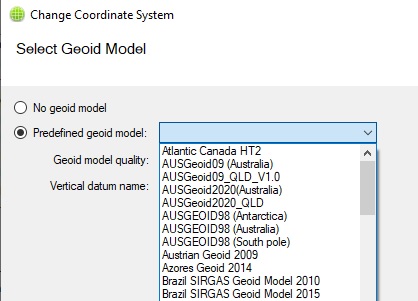

    I can select it but that one field doesn't complete which is just bizarre.
