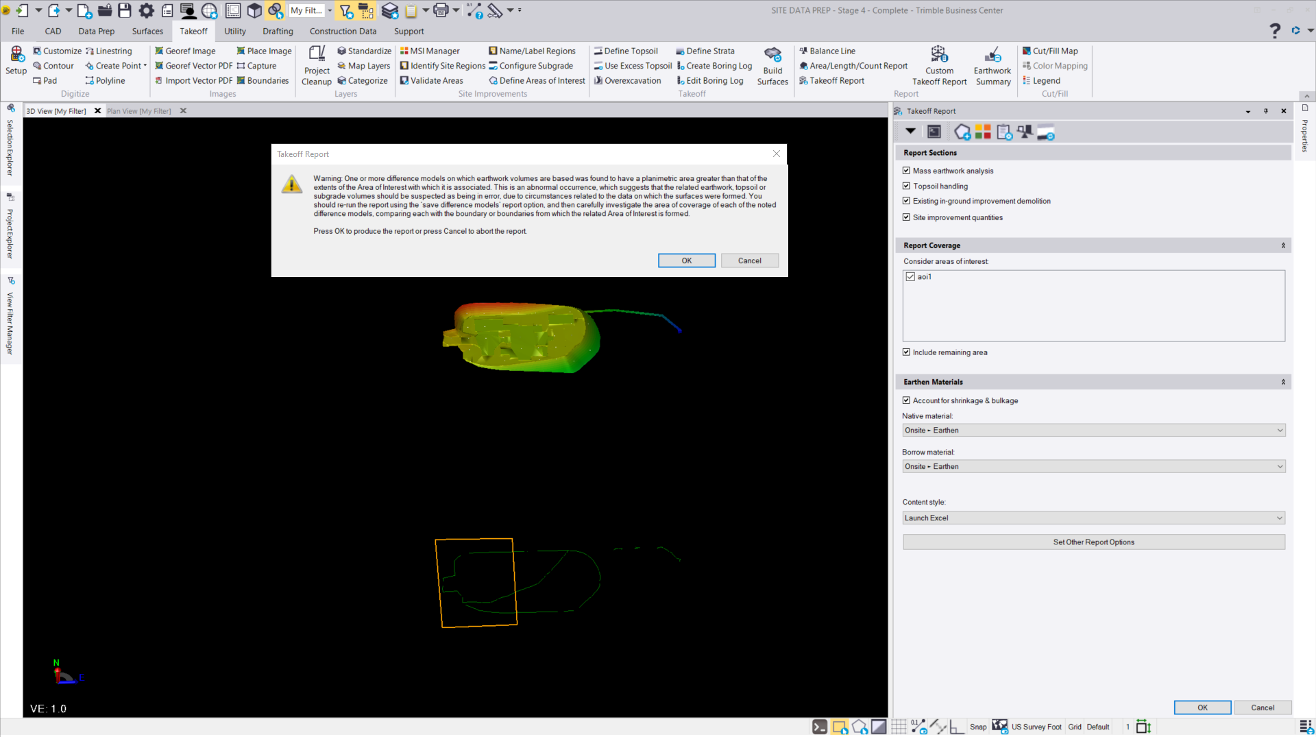

    You are absolutely right that the Takeoff Report has a specific use case. In order to utilize the Takeoff Report to produce the information you seek, you simply need to encompass all areas of the Takeoff Surfaces that you are interested in Site Improvement quantities with Areas Of Interest in such a way that there are no nested Areas Of Interest.
    Conversely, when a user chooses to enlcose only a portion of the Takeoff Surfaces with Areas Of Interest and chooses the Include Remaining Areas option, they are telling TBC that they don't really care about the various Site Improvement itemizations within the remaining area since there is no Area Of Interest defined and just want the remaining surface to surface volumes. That is why it just reports the surface to surface volumes and excludes the Site Improvements. Those volumes are accurate based on the input parameters chosen by the user. Like I said, I will do my best to ensure that nuance is more clearly communicated, though there's a pretty thorough warning message that pops up in TBC today explaining that there are potential problems related to AOIs as shown below:
    Regardless, you do bring up a valid point in just removing the option and forcing the user to define Areas Of Interest to include the entirety of the Takeoff Surfaces and the report will return the expected results. That would be pretty limiting to the users who are already using this function as intended, though.
