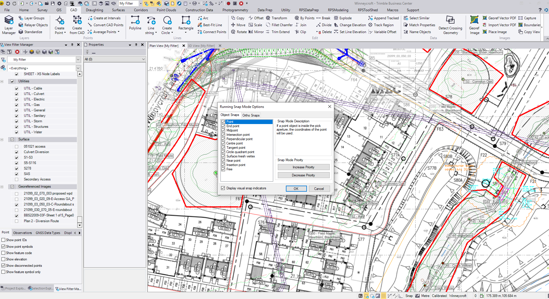

    Anyone else finding that some jobs aren't showing visual snap indicators despite having the tick box enabled?
    Seems that some of my jobs do and some don't, and I can't find the reason why.

    I'm not able to reproduce it on my end. Can you help us with more info on this issue? Are all snaps missing or just some? Does it seems to be a particular type of snap? Does it happen on a newly created project file or only on existing project files created prior to 5.60? Any more nuance or relevant info to help us reproduce the issue would be greatly appreciated!

    I'm  having all snap indicators missing. It's fine in some jobs but not in others, all of my jobs are pre 2.60 start.
    I can send you a .vcl if you fire me an email address.
    Again it's about 50/50 for jobs that don't have and do have snap indicators on.

    You're not alone. I'm finding running osnaps to be a struggles in 5.60 as well. Hopefully they are able confirm/acknowledge the issue and patch soon.

    I find it tends to be worse with vector pdfs loaded in the project.

    Same here. Also notice it more with PDF's. Very annoying.

    was this ever resolved? I have the same issue with v5.90, new projects are fine for a while and often a reboot will do the trick to restore the visibility of the snap indicators. Recently though I have a project that absolutely refuses to show snap indicators.

    I don't recall having a problem with this since I've updated to 2023.xx at all but that's only my experience and I tend to err on the side of caution now and only geo-reference 8-10 pdfs at a time as that was what seemed to be setting off the issue for me.

    Just ran into this with 2023.11. Messed with turning snaps on and off etc. No change. I shut down TBC and re-started it. That cured it for the time being.
