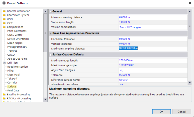

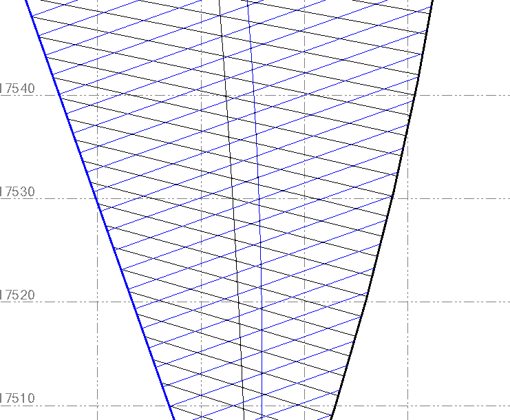

You might want to go into the project settings and lower the Maximum Sampling Distance. That way you can create additional nodes on straight segments and hence additional triangles in your surfaces. The denser those surfaces are the more accurate the intersection linestring will be.

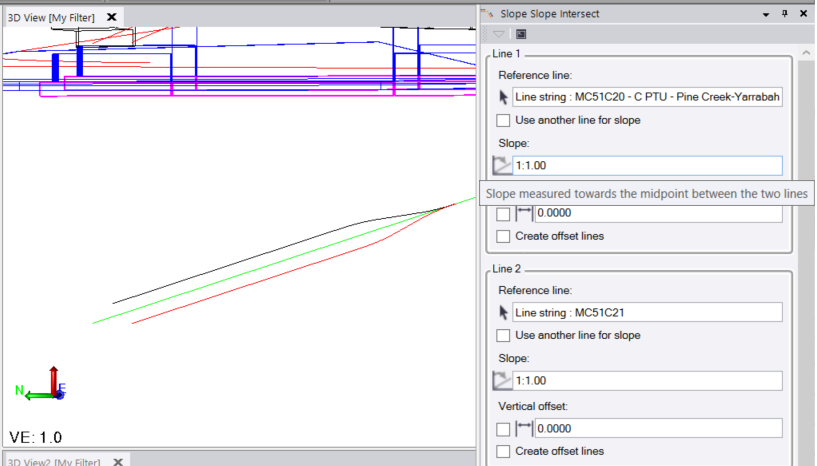

Since offsetting the lines is the best solution you can also try the Slope-Slope-Intersect Macro, that should have been installed with TBC. I don't know how it computes internally, if it keeps everything perpendicular to each string, you might want to compare the result to the DTM-Intersect-Solution. A quick compare with my two simple strings shows differences in the 5th decimal, so nearly nothing.

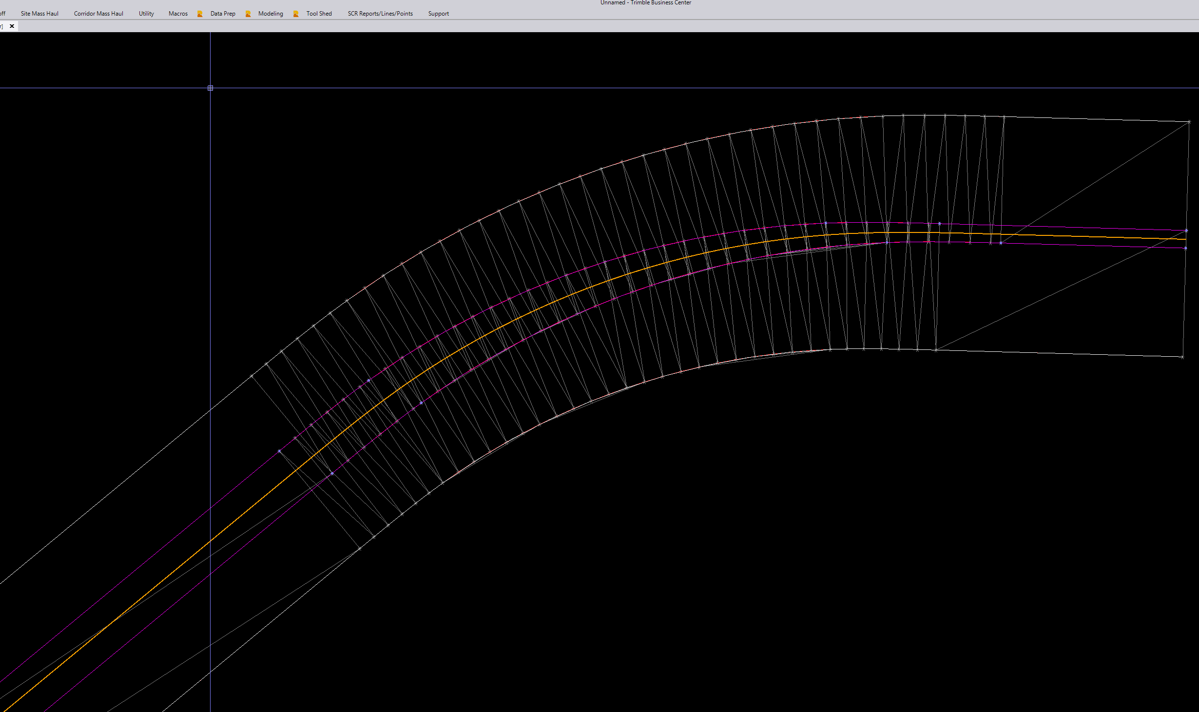

Set both alignments to elevation 1.00, offset each alignment 100' and vertically 1' across each other. For instance NB offset 100' *west and SB 100' *east. make surfaces out of the NB and its offset and the SB and its offset. Run the surface intersection and they will intersect in the middle.
