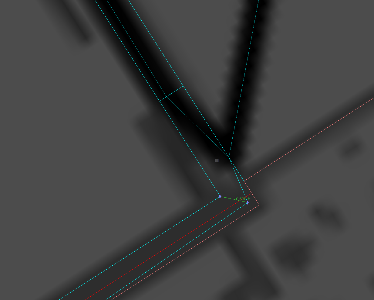

    I don't know if something changed on my settings or what-not, but suddenly when I set a .5' offset from face of curb, my offset lines are no longer 90 degree angles at corners. I've never had this issue before where the offset line is exactly .5' even at corners.
    Is this a 5.81 thing or did I accidentally change a setting?

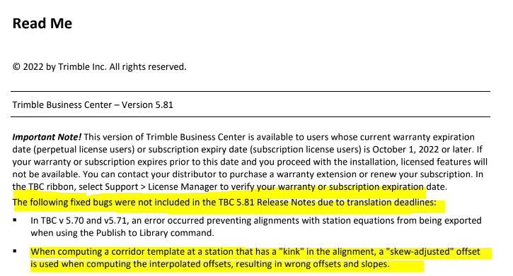

    It's not your settings.
    It's a known bug that has been fixed but not yet released.
    Temporary partial workaround: if possible, try to create "dummy" vertices 1ft before and after the kink.
