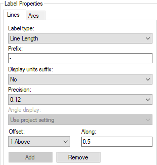

    I would like to ask TBC development to add as soon as possible a small, but very useful improvement in TBC.
    When creating a new LINE LABEL STYLES, in the LABEL PROPERTIES section are the following options:
    I would be very grateful to ADD to the options also a new one: SUFFIX.

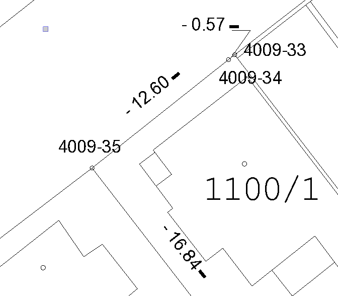

    When delivering the final printed documents for customers which deals with parcels and their border lengths,  we need to label
    the distances between corner points of line segments which have to have a dash (hyphen) in front of the length value, but also behind it:
    I use the hyphen in the Prefix field (see first picture) and it would be great to use it also in the Suffix field when it will be added.
    Now, since no Suffix is possible, I use a hyphen as CAD text and manually I add it next to the length values.
    It looks never like the Prefix and also significantly prolongs the time needed for processing such plans, when may line segments
    are to be labeled as requested by our norms.
