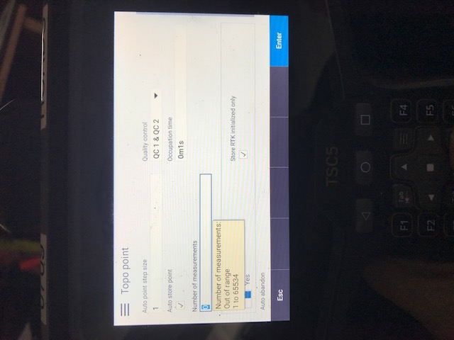

    Thanks Marian, I did just had a look at the settings/measurement profiles/GNSS R12i/settings for rover/ (I have a swedish language GUI...)
    in the first pic is the settings for rover, cant see anything about minimum epochs seconds in there ?
    second pic, if in measuring GPS mode and choose "rapidpoint" method and option at bottom screen, this is what I get, no epoch 1-9999 (?)
    third pic, in measuring GPS mode and choose "detailpoint" method, and option at bottom screen, no epoch 1-9999 there either (?), have tried setting this to 1 way back when I first got this equipm, and it has no real effect on measure time/registration

    3rd screen is the one you're after.
    Detalij punkt. Set QC to QC1 only.
    Mattid set to 1 second or 0 seconds if possible.
    Antal matningar (epochs) set to 1.
    Automatically save the points, do not prompt for attributes, do not see before storing.
    Turn off tilt corrections in R12i.
    It will be instantaneous.

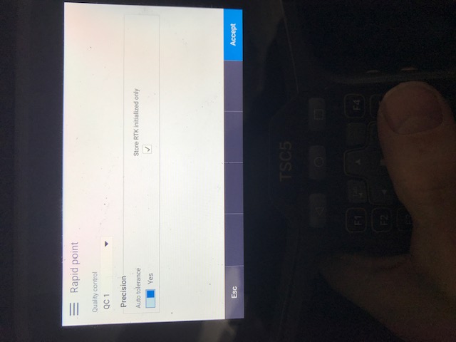

    i notice that on ours for rapid point you don t have too many options. just QC choices.

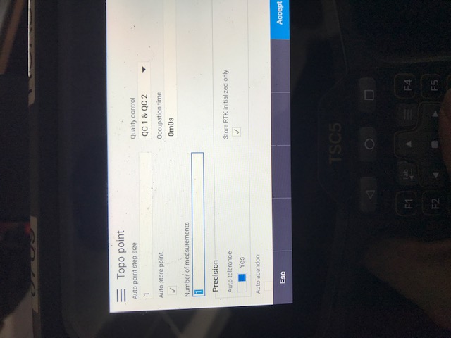

    but for topo you can chose how many epochs which i tried to put to 0 but it does not allow that. but there is also a time option. i had it at 1 second. but with marion s advice i see that it can drop to 0 seconds. i will try this and see if it makes a difference for us next time i am out.

    so i changed my topo point settings to as low as they will go. 0 seconds and 1 epoch. no tilt. QC1 only. this is still taking about 2 seconds to shoot. ironically you can watch the timer count up to two seconds when it is set to store on 0 seconds. i believe there is something wrong and we should have the option for instantaneous shot.
    rapid point is slightly faster than this but still not as fast(instantaneous) as survey pro with the same sp80/85 heads and likely the liecas brought up in the post.
