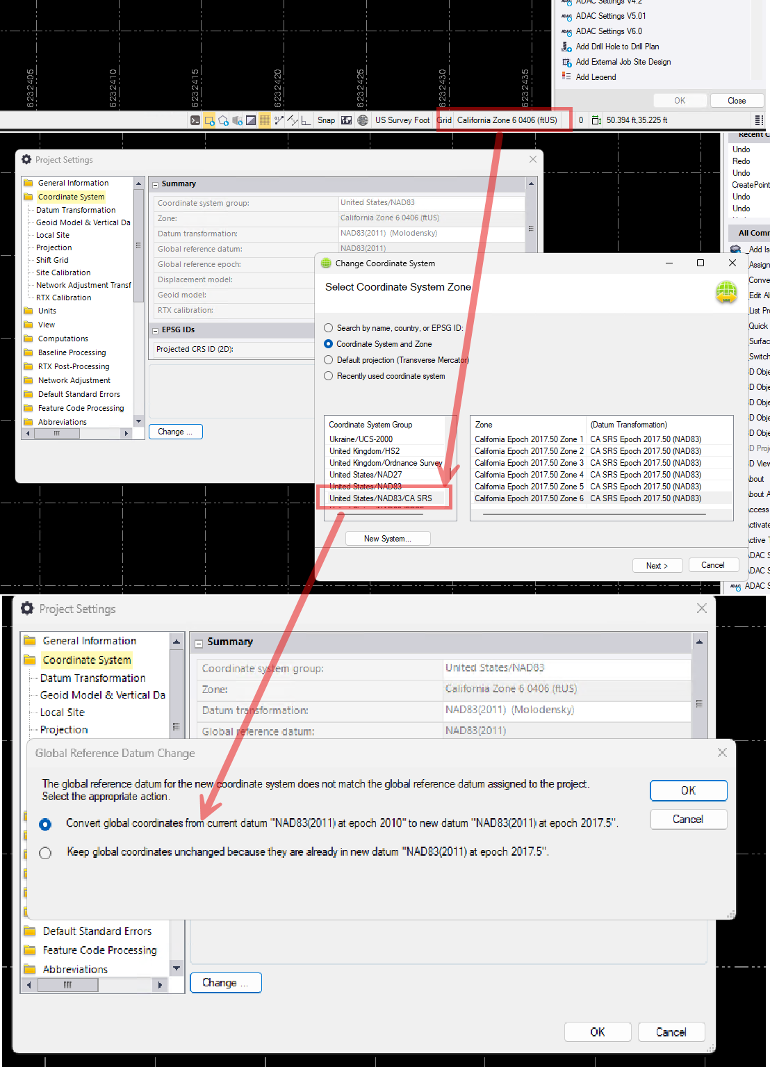

Aaron,
You'll want to update the coordinate system in the TBC project.
1. At the bottom of the screen select your current system.
2. Select United States / NAD83 / CA SRS - Zone 6 (probably)
3. In the pop-up menu select Convert Global Coordinates.

Good morning,
Can someone assist me with adjusting data to a 2017.5 epoch in TBC? New to this, trying to figure it out.
