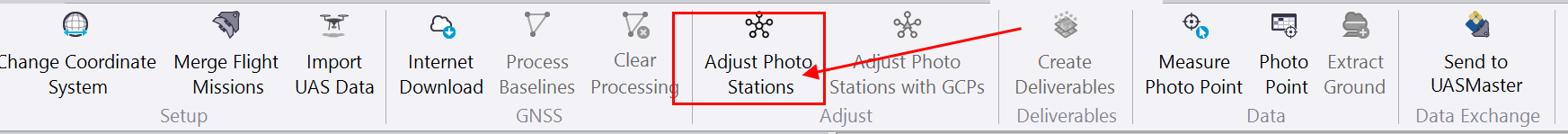

Greetings! Community, are you able to process photogrammetry data from m3e in the trimble business center? Namely, not to count the exact centers of photographs, but to calculate point clouds and orthophotos? I use version 5.81, during import - all data from this drone is loaded, a data import report is generated, but when you click the "Equalize photo stations" button, a fast progress bar goes through and shows the message "failed to process". It is noteworthy that when you click the "show report" button, the error file itself is empty. But at this moment two files are being formed in the project directory - txt and xml, and now the txt file is empty. The xml file inside contains the following inscription:

But this is strange, I bought a license, I thought that the problem was with this, I took a demo access for Trimble Business Center 5.81 on the second computer and tried to repeat it. Exactly the same result. Perhaps this forum can give me some advice on how to solve this problem?
