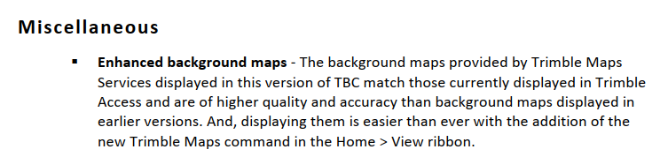

    I went through the old versions I have on my test machine, 5.6, 5.7, 5.8, 5.9, none of them work anymore. The first version the map starts to work again is 2023.10.
    I vaguely recall having read at some point that they're going to lock out older versions, due to a change in the security protocol or something like that. It may have been in conjunction with Trimble Connect and a notice popping up in Connect Synch. I can't find it in the TBC release notes.
    They do mention "Enhanced Background maps" in the 2023.10 release notes, but don't say explicitly that older TBC versions won't work anymore.

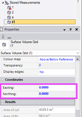

    Posted 02-20-2025 22:11
    Just adding to that rogue entity topic. I finally found the issue I had with one of my projects. Didn't really matter since I used an UpToDate orthophoto anyway.
    With everything enabled in the Viewfilter I had nothing showing up way off, or even at 0,0.
    It was an old "Stored Measurements - Surface Volume Grid" that must have come through with a VCL, and its coordinates set to 0,0. Don't even understand why it needs coordinates.
    The following prevents the background map to load.
    Even weirder, the following DOESN'T prevent the map to load.
