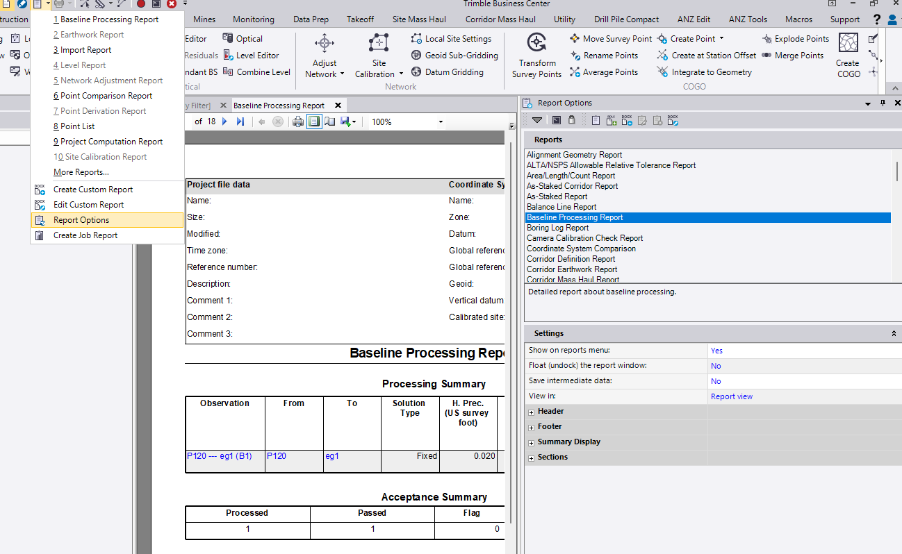

    Is there simplified version of the Baseline Processing Report?
    Just ran a control network with 240 vectors and the full report coming off the template is almost 2800 pages, when I all really care to review & archive at this point is the first 10 of the summary displaying the solution types & precisions. Generating the report & exporting it afterwards is quite taxing on my computer and often causes TBC to crash out.

    Fred,
    You should be able to adjust the report options. See the screenshot below. You should be able to turn off the sections that you don't need.
    Zach Edwards
  • 3.  RE: Baseline Processing Report, simplified version of summary?
    Posted 03-13-2026 07:36
    Ok thanks, think I do remember seeing that prior, and lost track of it yesterday as frustrations were running high
