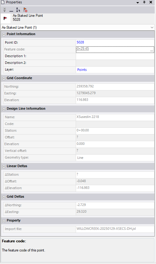

Sent: 02-02-2025 10:15
From: ian bissonnette
Subject: Can' Edit feature codes in TBC after importing JXL
i sure wish that tbc would let you change ALL greyed out values. sure, show a pop up that warns that you are changing a 'record' but most of the purpose of the processing stage of a project is to fix field records missed when out in the harsh realities of the world.
further to this as staked points AND coordinates should be 'linked' to the field data and have an option to allow them to move with network adjustments, again show a pop up warning what is going to happen. there are more days than not that we are on a project and use stakeout and then run a network adjustment. so many days that we ALWAYS convert as staked points and delete them.
ian bissonnette
Sent: 01-31-2025 13:03
From: Donnie Hughes
So I imported my JXL into TBC and now I can't edit the feature codes, it's greyed out. Any ideas on what's happening?
Donnie Hughes
