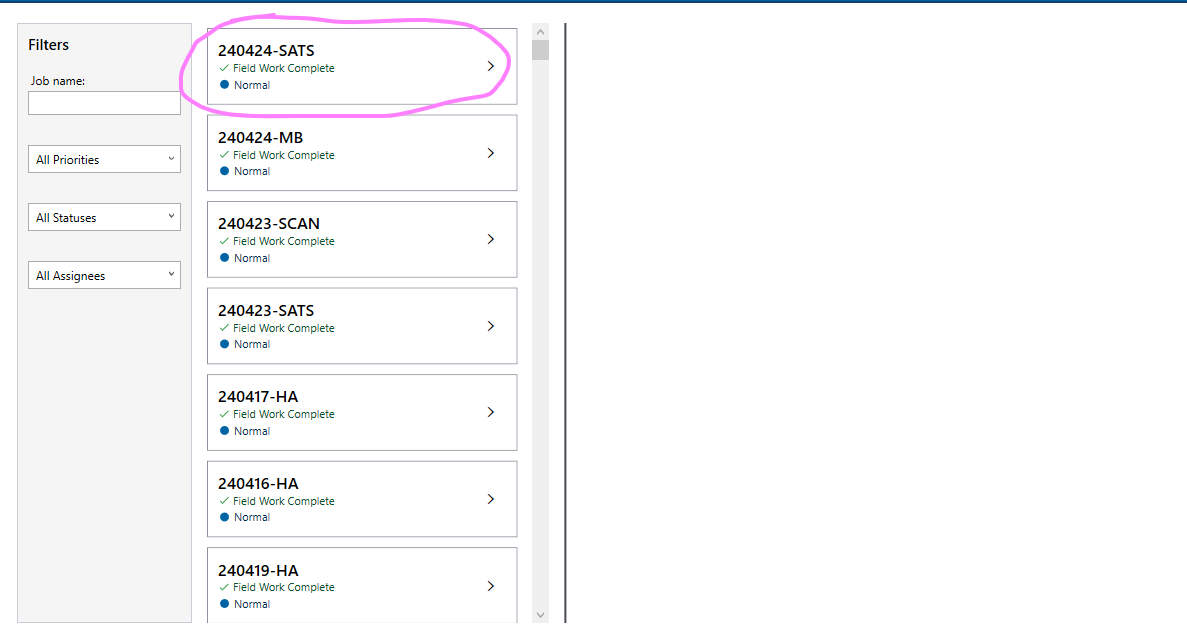

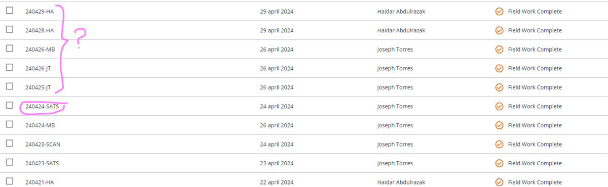

    I'm having this issue and it started after 2024-04-24 that files from the field are not showing up in the command Connected Workspace in TBC, anybody else having this issue?

    I've tried logging out and in TBC, used the command Connected Workspace no success. Tried the sync icon inside of Connected Workspace no success.
    I can see the job files in Trimble Connect and in Trimble Syns manager. See pictures.
    Job files in Trimble Sync Manager
    Job files in Trimble Connect
