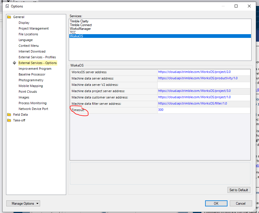

    I cannot see your screenshot, but I had similar issue few months back.
    Out Sitech/Trimble representative helped me by recommending increasing Timeout time when connecting to Works OS.

    Thanks Marian-san,
    Now this issue is solved.
    I think there is some change in WOS server or something.
    Thanks for your addvice and I'll try it if another issue is ocurred.
