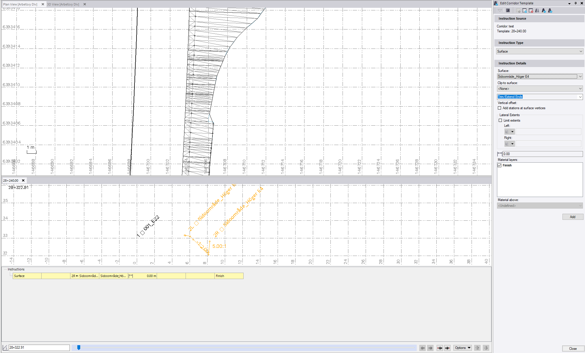

     I have problem, i want to get lines from a surface but cant find a easy way to do this. I will post a video, screenshot and the files here also. Here is the Video,
    and here is the CL and surface
    My problem is that i want to extract lines from a surface (they are alingned wit the center line) but if i use explode surface it will only give me part of the lines and som lines i dont want. But if i use corridor and add the surface as a instruction i can see marks in the xs for the nodes but i cant use them, if i could i would get exactly what i want. Any ideas?

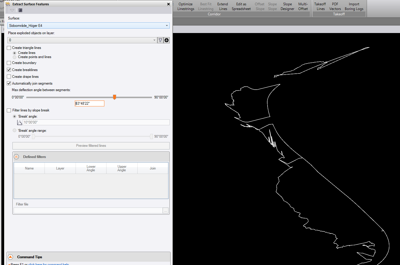

    I would use the  RPS Extract tool.  The surface you provided did not have the berm (pivot point).  I am running a little older version of TBC so my RPS tool maybe looking a bit different than yours.  You can see i extracted only the BREAKLINES from the surface.  Dont forget the join setting
    Francisco Guerrero
