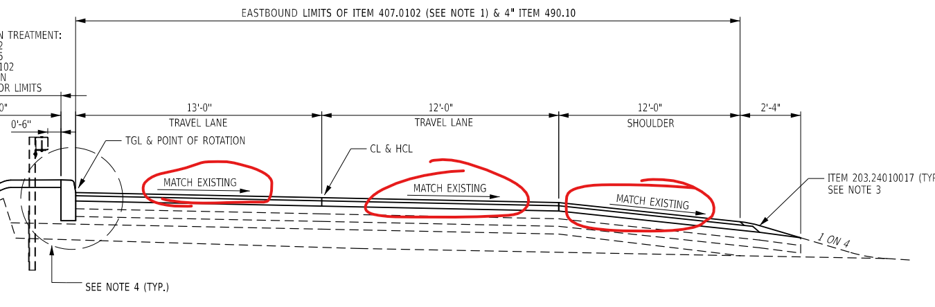

    Hello All,
    I've got a resurfacing project I'm working on, and I have an alignment as well as original ground surface.  I created a surface profile using the original ground and alignment to give the alignment vertical data.  The project is a 4" mill and fill, and the alignment has multiple supers, but no super table.  My question is, what instruction type and details would you use to match the existing roadway?  The slope of the existing roadway changes many times, especially in the supers.  But the only typical data given is to match existing.   Example below.
