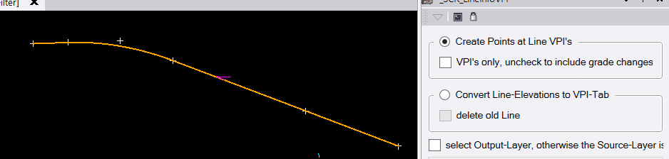

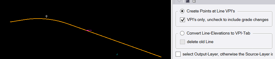

Have you tried SCR_LineInfoVPI from my public Macro repo? https://github.com/RonnySchneider/SCR_Macros_Public
You can choose to create only the literal points of intersection
or include the remaining grade breaks as well.
If it's not included in the VPI tab of the linestring/alignment it's not included, hence the option to convert first.
