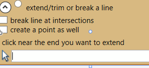

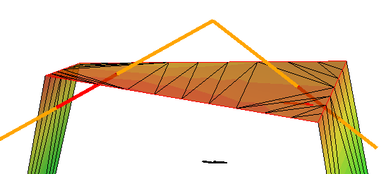

You can try SCR_DTMShot which is included in my public GitHub repo https://github.com/RonnySchneider/SCR_Macros_Public
- similar to what TBC provides with "Surface Intersect", but it doesn't ask for angles, simply 2 points (i.e. snapped along a line)
- can now also extend lines, just click near the end you want to extend
- works now with projected surfaces and IFC objects
It may not be 100% what you're looking for, I found it more beneficial to break the line at surface intersections (with the option to create simple CAD points)
