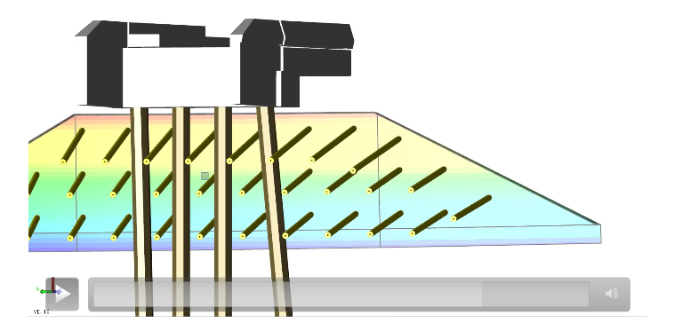

    In the meantime (my guess is that solids will be available in TBC 7.3 is released in 2026) I'd recommend Utilities module and custom shaped or rectangular shaped utilities runs

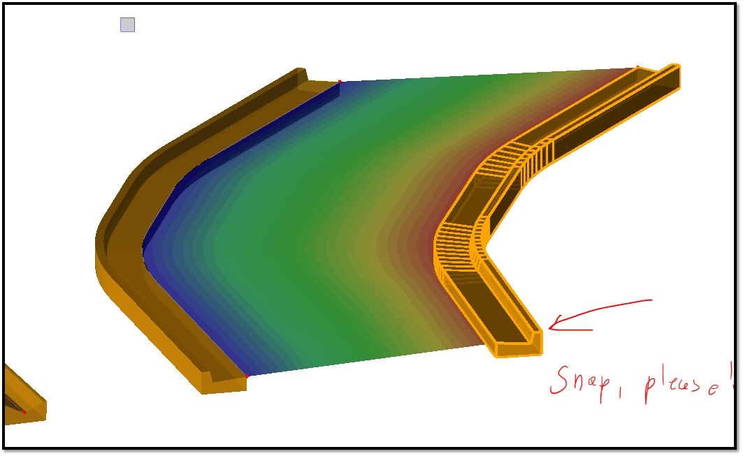

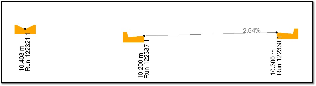

    Here's my yet another workaround: you cannot "use" (snap, export, explode) custom shape utilities, but you can export Rectangular and Circular utilities to TRB file. Then you can re-import your TRB, which will enable snap.
    It ain't perfect, but it "works" for certain workflows. E.g. I've been modelling soil-nails like that.
