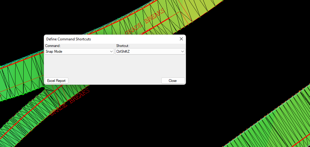

    fellas fellas,  why not create a shortcut for SNAP MODE.  I have this command setup on my ( i think its called this) one handed keyboard. buttone number 20. one push and open window for snaps.
    Francisco Guerrero
  • 17.  RE: DEAR TBC SANTA: All I want for Christmas; A TBC Wish List
    Posted 01-14-2025 06:58
    Thanks Francisco but opening up the dialogue box to setup the snaps wouldn't produce the desired effect to the work flow. We're actually looking for a one press on/off toggle of all the snaps regardless of the current status. The ultimate would be; hold the hot key down while clicking and no snaps (other then free of course) are applied. Then when the key is released, the previous snap state is restored.

    Regards the snap on/off issue can try my SCR_SwitchSnapMode macro. https://github.com/RonnySchneider/SCR_Macros_Public
    It's such a simple idea, but Trimble made it really cumbersome to achieve. If you look at the code, you'll see how complicate it is to set/trigger a specific snap mode. At least that's the solution I found with the "help" of the still non-existent macro documentation.
    from my help file:
    • best will be to apply a Keyboard-Shortcut like STRG+SHIFT+S to the macro
    • the macro DOESN'T affect Ortho-Snaps, only Object-Snaps
    • on start the macro will save current snap settings and "negate" what was enabled
    • this is based on the "No Snap" button in the macro
    • if that button was not toggled it will do that and set snaps to "Free" only, or otherwise sets this button to untoggled and restores previous snap settings
    • any change in the macro is immediate; no need for OK-button; hence you can immediately "Escape" out of it again
    • this way you can switch between Snaps/No-Snaps by just pressing some keys with one hand
    • as example:
      • press your shortcut -> snaps are disabled -> press Escape immediately and continue your work without snapping
      • next time you press your shortcut -> previous snaps are restored - > press Escape immediately and continue your work with snapping
    • the settings are saved with the project and not globally
