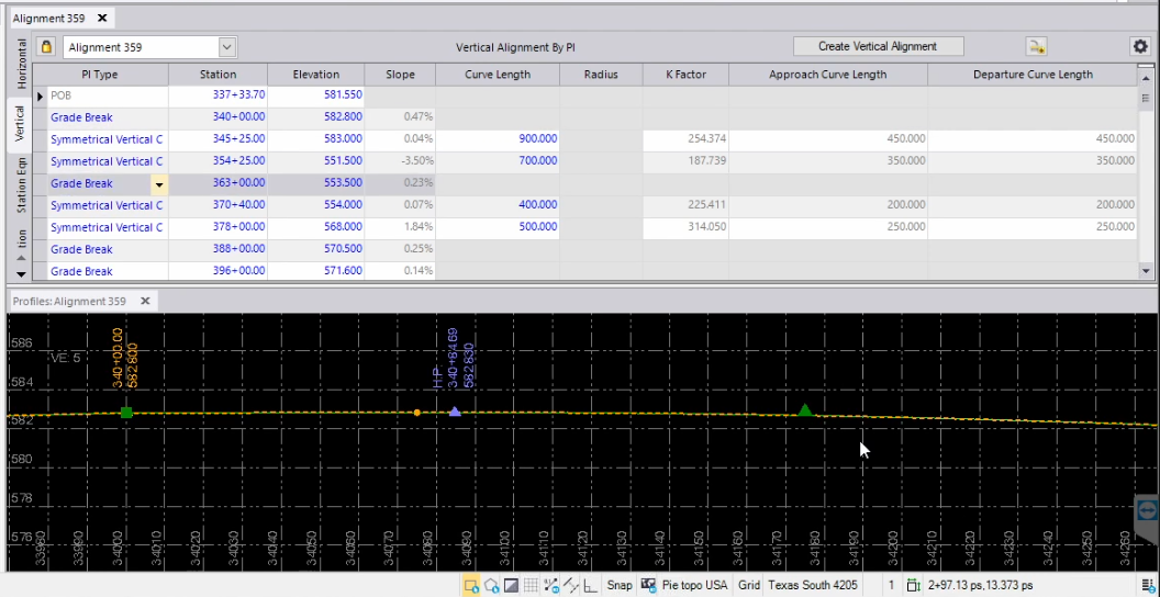

    My first doubt is the following,
    I have this coordinate point system, this is the side view, how can I get a view from above? Where I can appreciate the shape of the road and not just see it from the side, I want to see it from above.

    Is there any data in the Horizontal tab? That defines the alignments shape in XY. You need to open a Plan View to "see from above".

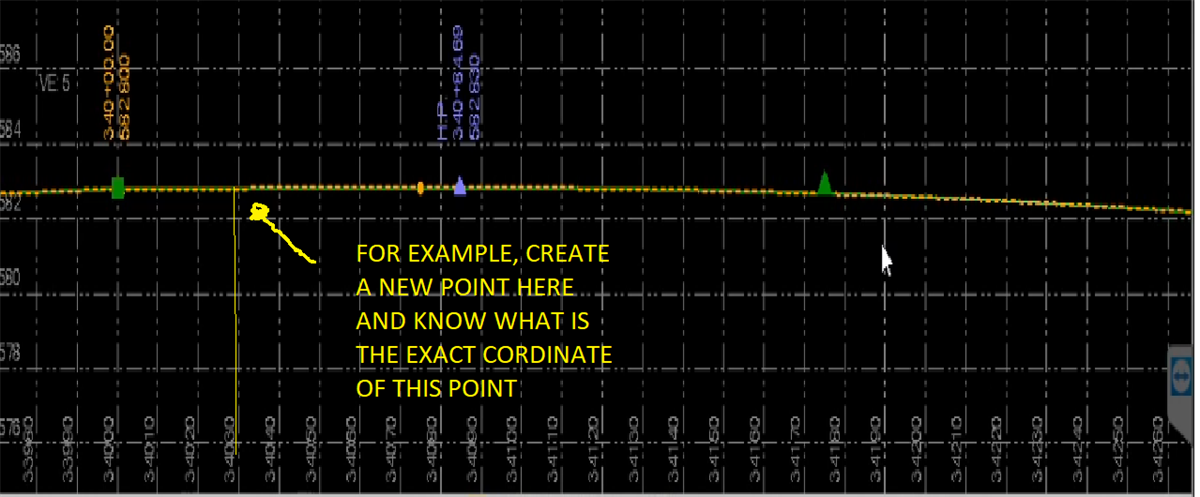

    Thanks! coming back to work I will check, another question, how can I know the coordinates of any point I decide? And at the same time, to be able to create another reference point at that coordinate.

    In plan view select the alignment then use Explore Object. There you can enter station and offset and it will show coords and elevation of the vertical alignment in the properties.
