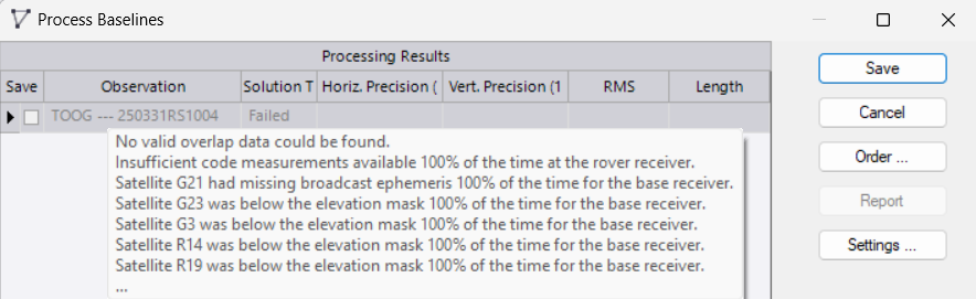

    Hola a todos,
    Me dirijo a este foro para plantear un inconveniente que me ha surgido y no entiendo porque.
    Al procesar una linea base entre dos puntos, me da como solucion "fallida" y no puedo obtener la causa, solo el mensaje "No se encontro datos superpuestos validos", cuando ambos registros se realizaron simultaneamente y puedo observarlo en sus datos.
    Adjunto la imagen:
    No se si a alguien le ha pasado esto, pero tengo el mismo problema utilizando un punto de vinculacion diferente.
    Aclaro es la primera vez que me sucede, por eso no entiendo que esta pasando.
    Agradezco cualquier comentario. -
    Saludos

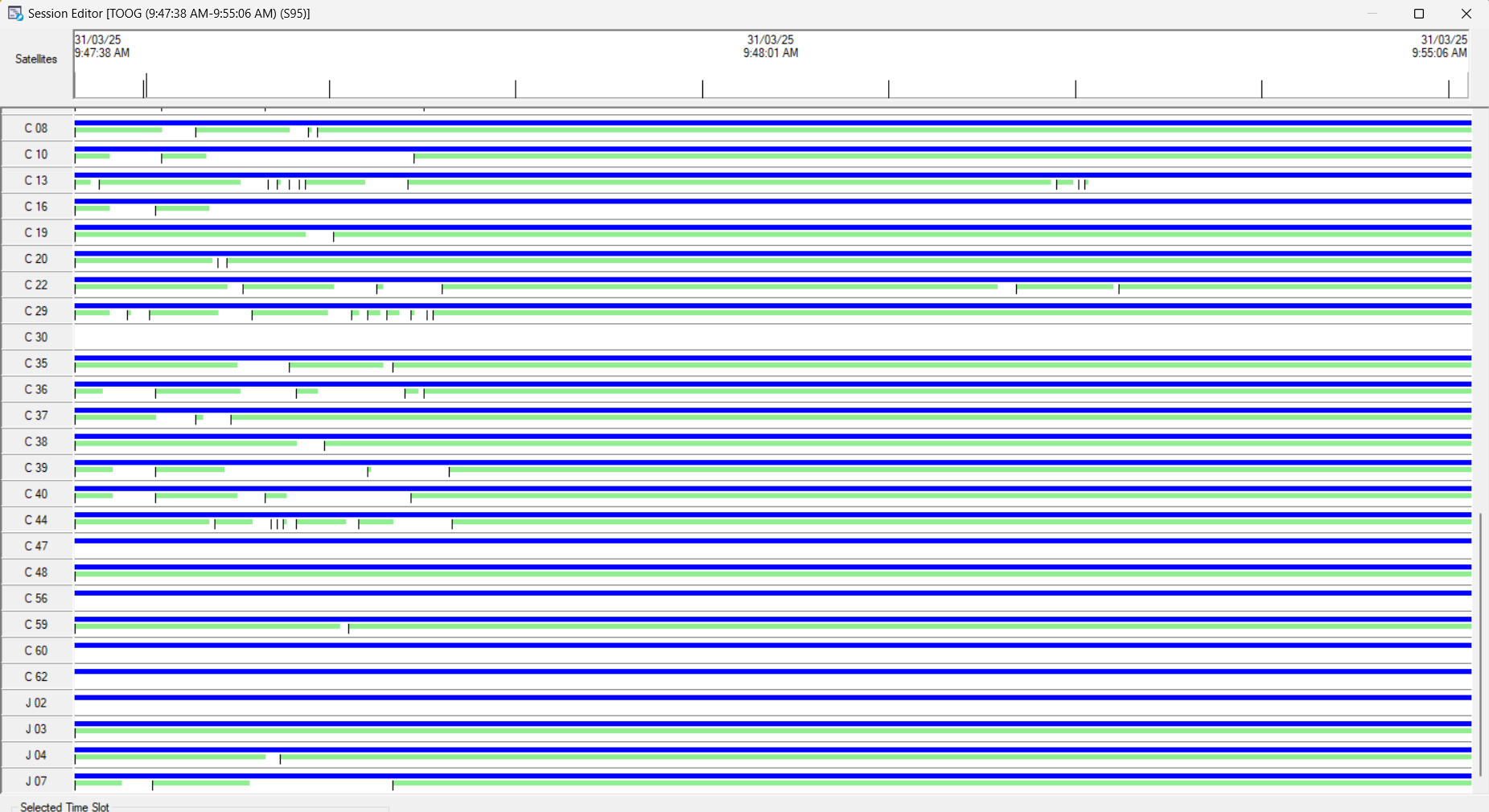

    Does your project only contain the data for this baseline, or does it also contain other/older baseline data?
    I did have a processing issue with V2024.10 recently when I had a project containing data dating 2-3 weeks back and bringing in additional new data. I had a similar error message, no overlap data found, although the session editor showed the overlap just fine. (is just some quick static for water levels along a creek with challenging canopy and rather long distance to base, 1 sec recording intervals on base/rover)

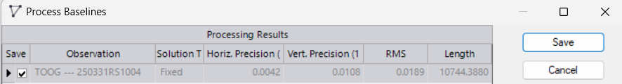

    I created a new/empty project, imported just the failing data, and it suddenly was able to process the baseline just fine.
    Since that was all I needed, I haven't investigated further yet. My hunch is that there is an issue with the ephemeris database, and it selects/computes with outdated ephemeris data.
