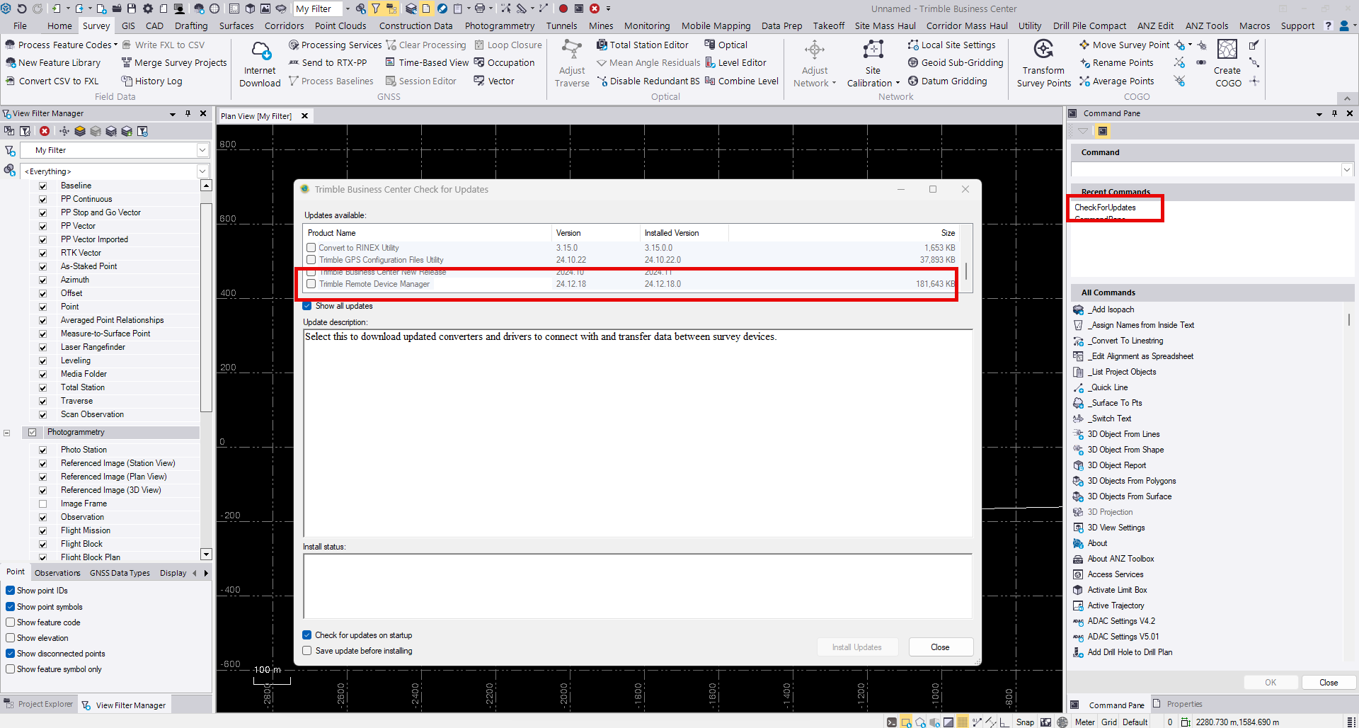

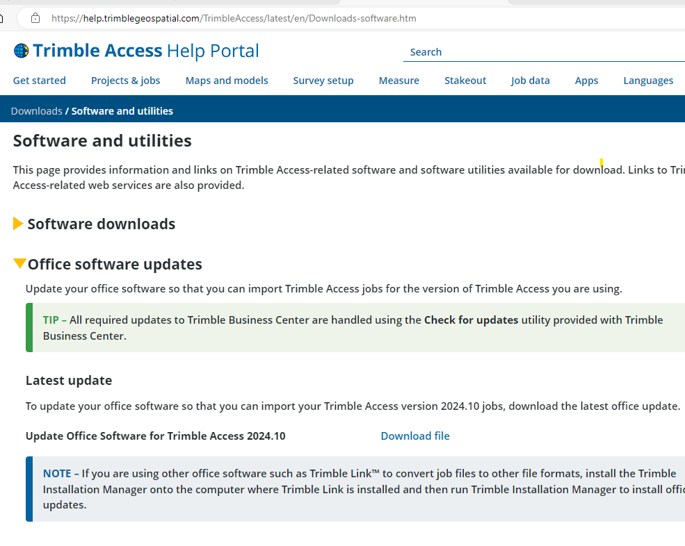

It looks like this might be related to the current job converters installed on your machine. TA had a release after TBC's latest updated. Try running the check for updates command in TBC. You might see an update available for "Trimble Remote Device Manager".

I am having issues importing JOB files from an SX10 with scan data into TBC version 2024.10. The error message says its a conversion issue. Any assistance would be greatly appreciated. Thanks
