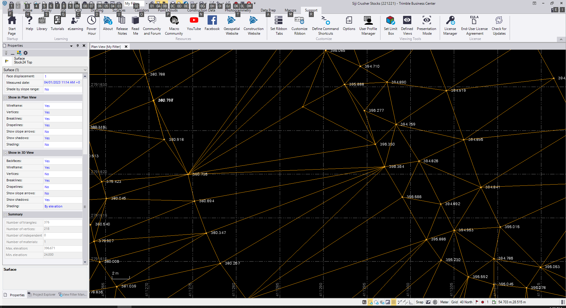

    I have created a surface from observed points.
    On examination, find there is one rogue vertex (See screen shot). There is no point here!! How to eliminate this? Swap triangles did not work.
    The properties window for the surface shows a Min Elevation of 24.000 m. Which is way out.

    If you select your surface and then right-click and "Select Members" you'll see that you've added the text Stock24 as a member of the surface.
    Just select that text and remove it as member and the spike will be gone.

    Great.
    Done
