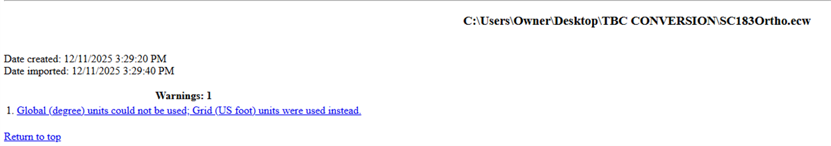

    I just received the imagery from the mapper on a project. Do the drag and drop to import the imagery into the working file and get the error shown below:
    my units for the project are International Feet not US survey Feet and the image appears to be roughly 2-3 feet west of the mapped locations. Am i missing a setting for the imagery units?
