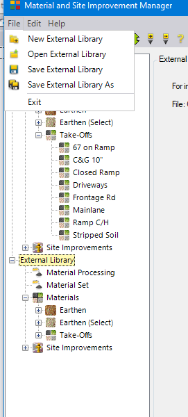

    inside the MSi Manager.  you will go to File > New External Library.  after you see the External Library tab at the bottom of the list.  you can then go up to your existing material  and right click.  you will see on the pop up window an option to "copy to Library"  those materials will then be copied to that External Library and from there you can now Save External Library.
