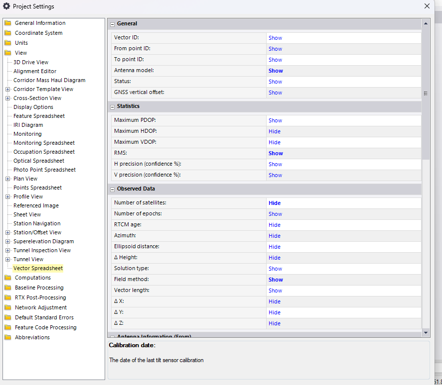

I believe due to how Trimble calculates the H and V precision, you won't get individual X and Y precision. I also don't see this in settings-->View-->Vector Spreadsheet from a columns perspective. There could be a way to get this upon export if you create a custom CSV export.

G'day, I have created a new export style in TBC that exports many variables including the GNSS vector obs.H.precision and GNSS vector obs.V.precision. All of this works great but I can't figure out whether one can reduce the H.precision to two components (i.e. x & y precision)? Is this possible?
Thanks
Jon
