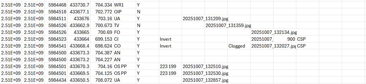

yes, shawn this is what i was trying to describe.
to the original question. we custom export from tbc, feature codes and attributes, in a csv. comma delimitator. the attributes come out in different columns:
i was trying to describe building your fxl with blank entries if you wanted to delete a whole column from the csv before going into civil. we typically have to do some csv manipulations anyways mostly because of alpha point numbers.
and i guess the other point i was making is that the column does not really matter if the description keys are setup to know what they are looking for in each column. the photo attribute can be useful in civil even if not linked.
