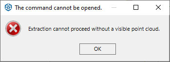

    I am struck here.
    Can someone help me.
    Thanks.

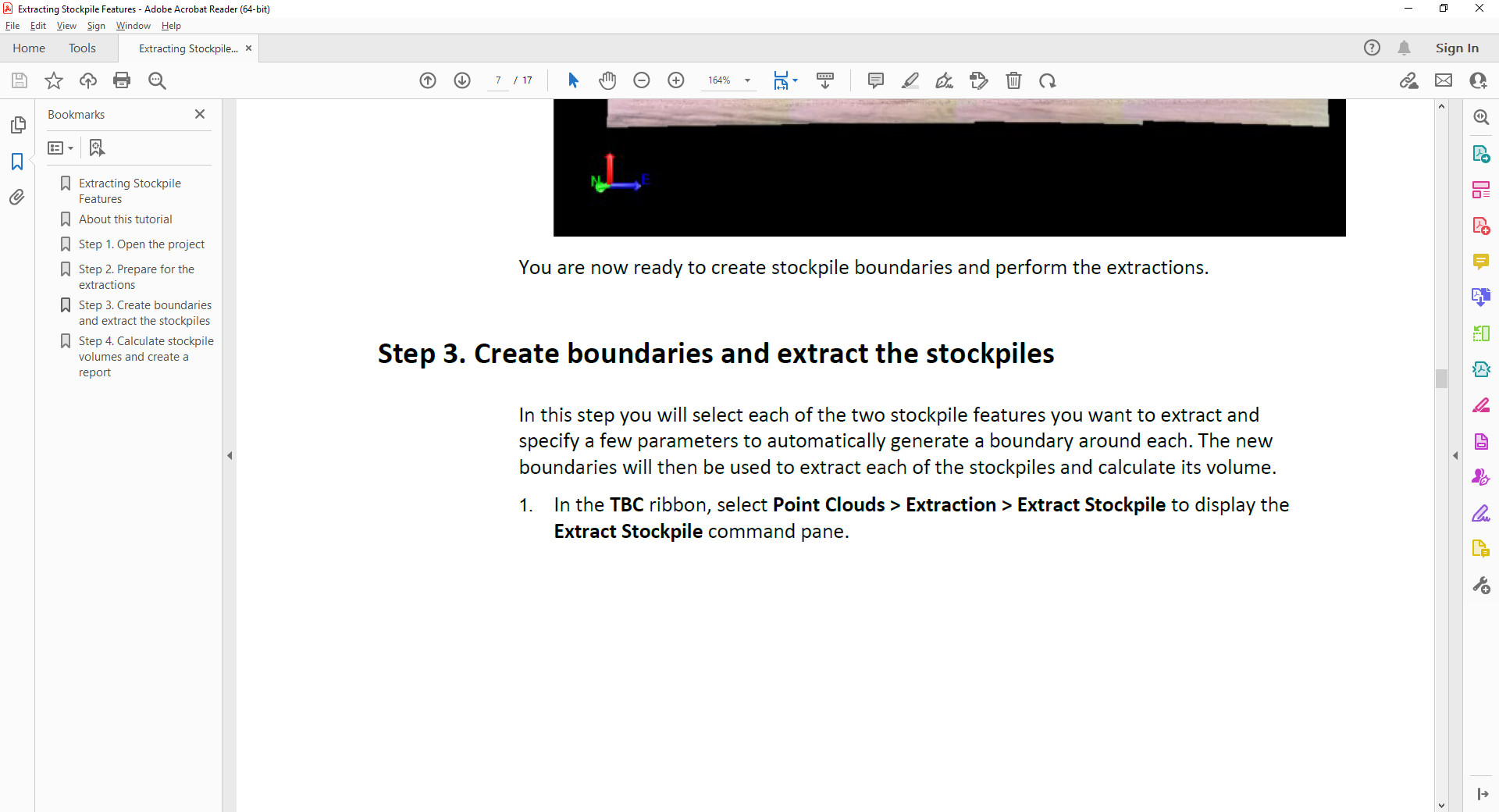

    Also, can I use this and other related commands of "Point Clouds" command to extract stockpiles from Pointcloud generated by Aerial Photogrammetry.
    Thanks.

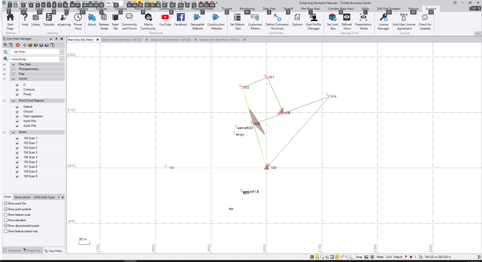

    Hi Saif
    It looks like your point cloud data has been switch off in the View Filter Manager. Please ensure you can see your point cloud data in TBC and then try the command again. You can use aerial photogrammetry point cloud for this command.

    Yes it worked.
    Thanks.
