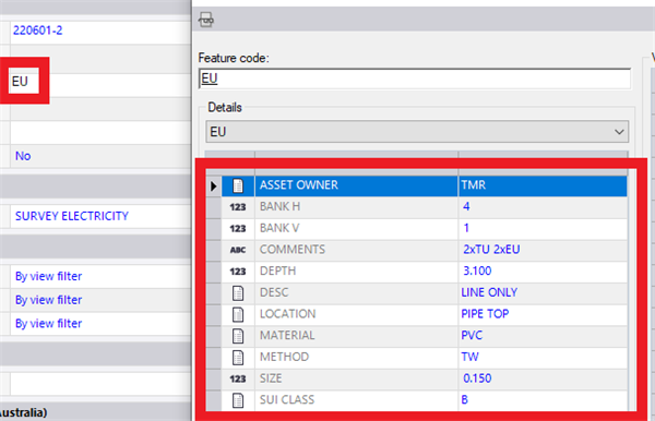

    I have to work on a project where Feature Codes for a line feature were used without a string number. Now every time the different .job files are reprocessed the lines for the features go all over the place. Now after I added or changed a string number the lines came up the way I wanted to. But when I looked at a single point all the attributes where gone. Most important the attributes contain an individual depth information, which I require.
    I could go back to a previous version of the TBC project. So I still have the information I need. I tested it for a single point. If I add a string number to the Feature Code the attributes are lost. And I have about 1,000 points in the project. See screen snippets below.
    How can I retain the attribute information and change the string number of a Line Feature Code? Any work around?
