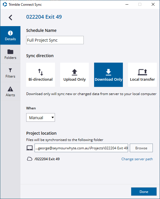

    I have been moving away from the TSM and to Trimble connect. Has been more stable and much faster on large projects. I have found it behaves more like one drive in that you can nominate a one-way sync so that field crews can't delete or change the field files required - Just log in in to Trimble connect sync on the TSC7 and automatically get all office changes (download only has to be selected in Trimble Connect Sync).

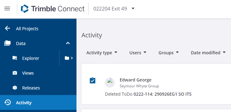

    Connect also tracks all changes made to the project via the Activity tab which is invaluable for traceability.

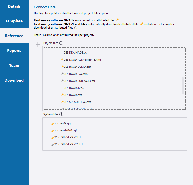

    Posted 10-10-2023 21:02
    At the moment I've been using this (see image). because it auto downloads to all controllers assigned to the project. and doesn't leave it up to the field crew to be checking / missing new files all the time.
    with the move of TSM to Connect. would there be a way to select that must be downloaded to the controller?
    regards
    Peter Batson
  • 9.  RE: Feature Request - 12da in Trimble Sync Manager
    Posted 10-11-2023 16:22
    Hello Peter,
    All files in Project properties - Reference should be able to be flagged for automatic download.
    Can you confirm you are using TSM version 2.01.7. My screenshot shows the link option as available.
    I do have "pushed automatic download" in the Connect requirements list.
    Do I understand correctly that you want the latest versions of certain files selected by yourself to be downloaded to all controllers without the Surveyor having to think about it too much?
    Would this extend to being able to confirm from the office that all controllers have the latest version of each file downloaded?
    Chay
