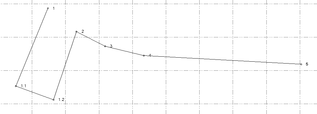

    I have run into the similar situation before. But in the latest 5.40 release, the problem seems to be solved. See below. I created points 1 to 5 first, assigned a line feature code (EPMT) to them, processed feature codes. Then I added two points 1.1 and 1.2, assigned the same code to them, and recomputed the project. TBC updated the line as expected.
    Please give it a try in 5.40 and see if this solves the problem. Thank you.
