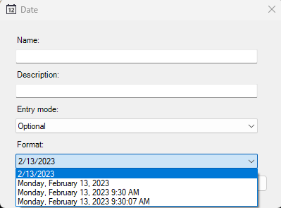

    Yes and No.
    Yes you can set the date format a few different ways. But you either get mm/dd/yyyy or dd/mm/yyyy depending on your install language.
    Image below you can see I have American english installed and I only have the option for mm/dd/yyyy.
    If I am missing something, please let me know.
    SL

  • 7.  RE: FXL DATE ATTRIBUTE
    Posted 02-13-2023 10:45
    You are correct.
    I got locked in on the request that the date be available, with the subsequent agreement to that request seeming to validate the need for this to be added. Since the request is already available, I was trying to get people to help themselves, regrettably without verifying for myself the formats that were later requested are available. We're dealing with 2 separate issues. The OP wanted to be able to add a date in a format that is available, while the follow-on commentary was a request for an enhancement for the code features.
