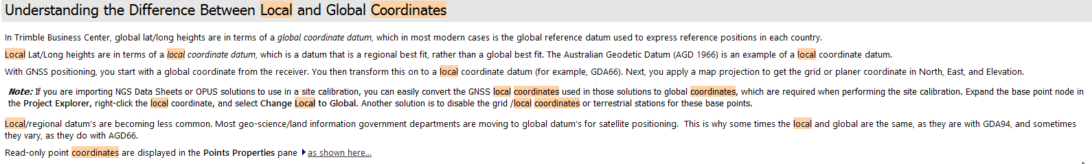

    Can someone give me the low down on global vs local coordinates in TBC?
    Sometimes they are the same, sometimes they are different.
    Sometimes the global coordinate will produce a grid value in state plane but not the local, other times they both will.
    I have a really hard time understanding when to submit a lat/long coordinate as global or local and what the two really mean relative to each other and just generally how the TBC processing engine handles both of them.
    Thanks so much!

    From TBC help:
    Michael Fletcher
